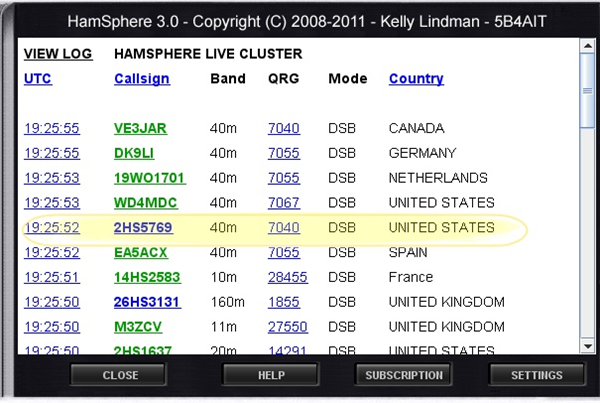

This built-in LOGBOOK – Captures QSO information while using HamSphere Radio.
This LOG Book is combined with the LIVE CLUSTER screen starting in HamSphere version 3.0. Not available in version 2.0 !

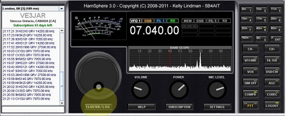

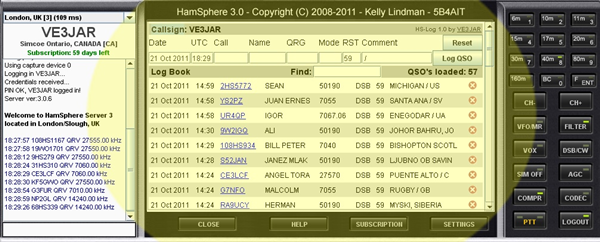

On the RADIO screen you notice the button called “ CLUSTER / LOG “

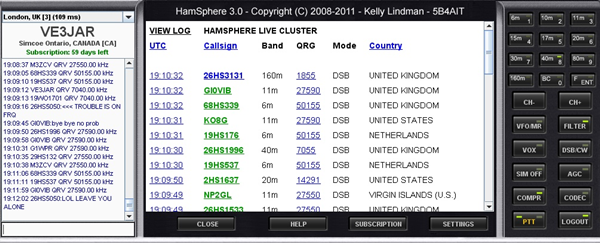

When you click this button you switch to the LIVE CLUSTER.
Yes this screen you can see all users that are logged in on HamSphere radio.
The scroll bar allows you to move up & down to see more users callsigns.
You also have the option of sorting this list by Callsign & by Country
This may help you in finding the specific Callsign that you wish to enter into your LOGBOOK
CREATE LOG ENTRIES by the ONE CLICK METHOD
To initiate the LOG ENTRY…CLICK on the UTC time (which is underlined)
You can EDIT some text if you like TYPE OVER.
Make additional comments in the COMMENT FIELD...
Click the LOG QSO button

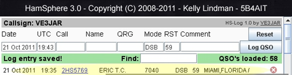

ONCE THE LOG QSO BUTTON is CLICKED YOUR ENTRY HAS BEEN MADE ......
QSO Logging confirmed COMPLETED
Notice that the green line which indicates the SAVE process was completed
Also notice the QSO LOADED counter was updated by 1 entry.
This data is stored on the HamSphere Web database.
TO go back to the Radio. ……Click the “CLOSE button.

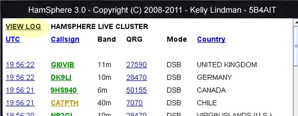

Important .....changed location of VIEW LOG button!!!
CLICK on the VIEW LOG button (upper right corner of the Live Cluster screen)
Then you advance to the LOG BOOK screen

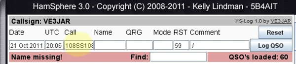

If the Callsign is not in the DATABASE
Or
Possible CALLSIGN is TYPED incorrectly
There is an ALERT (RED LINE) a warning for you to correct
Upon investigation you notice Callsign is not correct………….
Edit the Callsign and CLICK LOG QSO the second time………………
Remember even if the CALLSIGN is not in the database it will make an entry…when you manually fill in all fields……..…but some country information will still be missing in the overall database record.

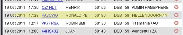

IN this case PA3CWG for example name is RONALD PE and you want to change that to only read RONALD
CLICK on the CALLSIGN (underlined)
As you correct fields by using the keyboard delete key, you may notice more characters in the field than were not visible in the small windows.
Remember the information is the text Users supplied when FIRST Registering –
Setting up their Accounts in HamSphere.
The date/time can be changed in the edit mode.
When satisfied with the EDIT process
Click on the SAVE button………

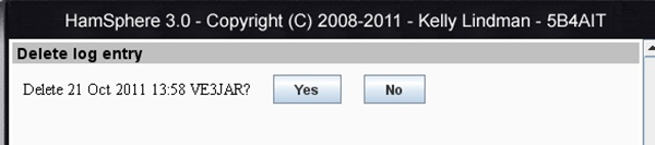

DELITE LOG ENTRIES
From time to time you may wish to DELETE an existing entry in your LogBook.
USERS doing some logbook maintenance / data cleanup…
Maybe you found duplicate entries
Maybe an entry went in my mistake.
Any time you are in the VIEW LOG screen
You will notice RIGHT SIDE of the screen a RED CIRCLE with an “X”
This is the Delete Symbol and if pressed will initiate that record to be deleted.
Upon clicking this Symbol on a specific record will initiate the DELETE process.
This screen will come up as a safeguard
You have a chance to Cancel this delete process by clicking “No
You can confirm to continue and DELETE / Removing record by clicking “Yes”
Program goes back to VIEW LOG screen…………
To go back to the Radio screen CLICK the “CLOSE “ button

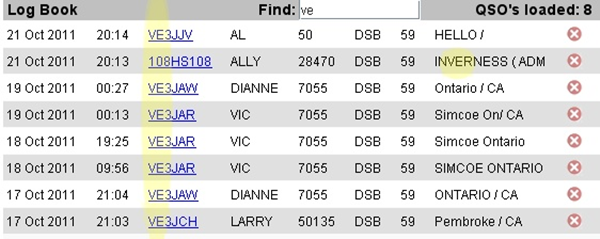

Examples 1
If you type in the FIND box " ve " hit the ENTER keyboard key
You see the result include callsigns with “VE” & in other fields there may also include ve in other words…So the more exact you are in selection criteria the less hits in field you do not with to search……….

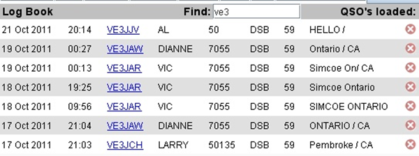

Examples 2
If you type in the FIND box " ve3 " hit ENTER keyboard key
This time was more exact criteria
You eliminate the comment field in this particular find routine.

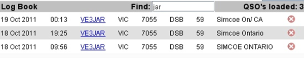

If you type in the FIND box " jar " hit Enter keyboard key
This time being more specific the results gets results closer to your wishes.
This could be used if you wanted to edit a record / delete a record with VE3JAR in it….

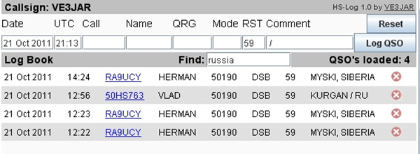

If you type in the FIND box " russia " hit ENTER keyboard key
Result show in list, the number of QSO that you had with Russia & QSO LOADED 4

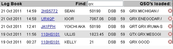

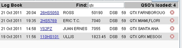

USERS wishing to keep track of QSL Card Sent / Rcvd can do so by being creative.
An option would be to use the COMMENT field to embed codes / consistent words
Such as a code could be consistently used to aid in retrieving desired information.
EXAMPLE: ----- Tip [ Do Not use punctuation like / ' " etc ]
QRX = for card received
QTX = for card sent.
Maintenance is important and required to update logbook as the situation changes
Using the FIND & EDIT modes MAINTENNACE can be performed easily.
To find station in the logbook with QRX records flagged, = QSL CARD RCVD.
To find station in the logbook with QTX records flagged, = QSLCQARD SENT.
